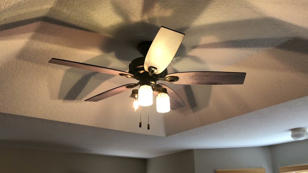

And here it is the strobe effect with the same light bulb (mentioned in this thread) that “apparently works” for someone else.
Do you mind sharing the make/model? I would love to test them and share the results here.
I was able to find something that “works”.
If you look close you will notice a little bump towards the end of the ramp up (while tunring it on) but again: only if you are standing there and looking for it.
If we consider incandescent experience 100%, I will give this one a 97% because of the ramp up. Everything else is great (as far as LED goes).
Here it is in case someone comes across this thread looking for an LZW36 compatible bulb:
