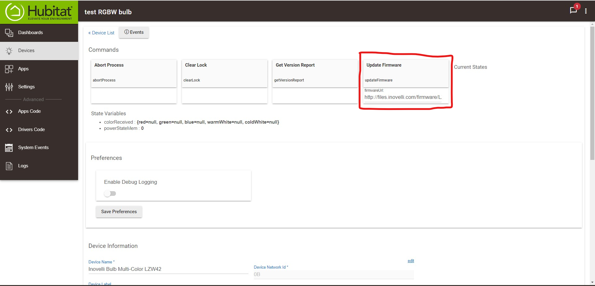

Since I’m so new I haven’t done a firmware upgrade to any of my devices yet. I started at this page:
I saw the table for the Black and Red Series which said the latest OTZ is 1.48 and the BIN that goes with it is 1.47. But when I clicked on the link to take me to the Red Series, LZW31-SN, firmware, it took me here:
and there is no 1.47 BIN file. For 1.48 the BIN file is 1.41 and even for 1.53 Beta it is 1.43. I know that is for the Red Series and we are talking about the Fan/Light LZW36 here, but I don’t know what I can trust. It seems the chart on the Wiki page should be the official page with the correct version. If those numbers aren’t right I don’t know what else to trust about the instructions.
Plus, those instructions talk about having to do the update in 2 steps: step one is for the OTZ and then a second step for the BIN file. It also says the files should be downloaded first and I have to change the parameter to 0 for the OTZ file and then to set it to 1 for the BIN file. But then I found other instructions that seem like they are saying there is a new firmware install app that does it in one step and I just need the URL without having to set the parameter between 0 and 1. Here are links to what seems the newer version of the Z Wave Firmware Updater:
and
I’m also confused by the instructions for the “new” URL based version as it seems like there are 2 URLs, one for the OTZ and one for the BIN but neither of the above 2 links say to do one and then the other. The instructions just say:
Your screen will refresh and the box on the far right will say Update Firmware. In the firmwareUrl: box paste the URL you need from above (obtained in the “Firmware Location” section above). Once the URL is there, click the Gray Update Firmware box directly above the URL. The Current States section will begin to update and you will see a percentage indicator. It will say 100% complete when the device is done updating. We have seen the update process take somewhere between 3 and 40 minutes per unit. For better performance, update your device closer to the hub.
Step 10
Once the device has completed updating, change your Device Driver back to your old driver, click Save Device and you are all set! :+1: Enjoy your new firmware!
As you can see, those above instructions don’t say anywhere to then repeat pasting in the URL but with the other URL before changing the Device Driver back to the old driver. It only mentions pasting in the URL once.
Maybe that is obvious to you that this process is then repeated with the other URL, but I’ve never done this before, so nothing is “obvious” - especially when it warns I can brick my device if I do it wrong. So I don’t want to paste in 2 URLs and repeat when I shouldn’t and likewise don’t want to only paste in 1 URL if I should then repeat that step but with the other URL. I’m going literally step-by-step as to what it says to do and it doesn’t say to repeat with the other URL.
So, I’m happy to try it, but I still need some guidance.
BTW, am I correct that this means we do NOT use the Hubitat built in Device Firmware Updater and I don’t have to change the parameters for 0 and 1 like the first link I started with says in the official Knowledge Base? (here:)
Final question: I’m 99% sure I got the newest version of the Z-Wave Firmware Updater, but how can I be sure? The version said it was 1.00 at the top of the code when it was brought in, which seems wrong if there was a prior version.

I’m 99.9% sure I got the latest version as it was asking for the URL. For the Fan/Light I pasted in:
https://files.inovelli.com/firmware/LZW36/Beta/LZW36_1.36.gbl
When I clicked on the Update Firmware button just above where I pasted in the URL I saw the Current States change firmwareUpdateProgress to Please wake up sleepy device and lockedBy changed to This process (See screen shot below).
The light for the fan I was trying to upgrade was on, so I don’t know what they mean to wake up a sleepy device or how to do it. What do I do now?
Thanks,
Stuart
It looks like that’s happened before to others - [RELEASE] Z-Wave Firmware Updater - #114 by bcopeland - ⚙️ Custom Apps and Drivers - Hubitat
Solutions seems to vary between resetting the device by pulling the airgap, restarting the hub, and/or doing an exclude/reinclude before reattempting the update.
