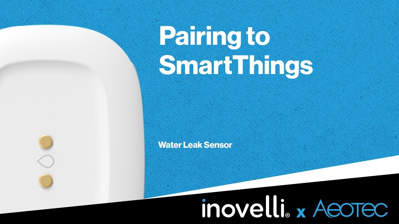

2. Initiate Pairing on the Hub
After you’ve initiated pairing on your sensor, it should be flashing yellow and red (reminder, you will have 2 minutes until it times out).
If it’s not flashing, please press down on the button on the back of the sensor for 2-3 seconds (click below for a visual).
Visual
Feel free to follow the written instructions below by clicking the drop down or follow along with the video below:
