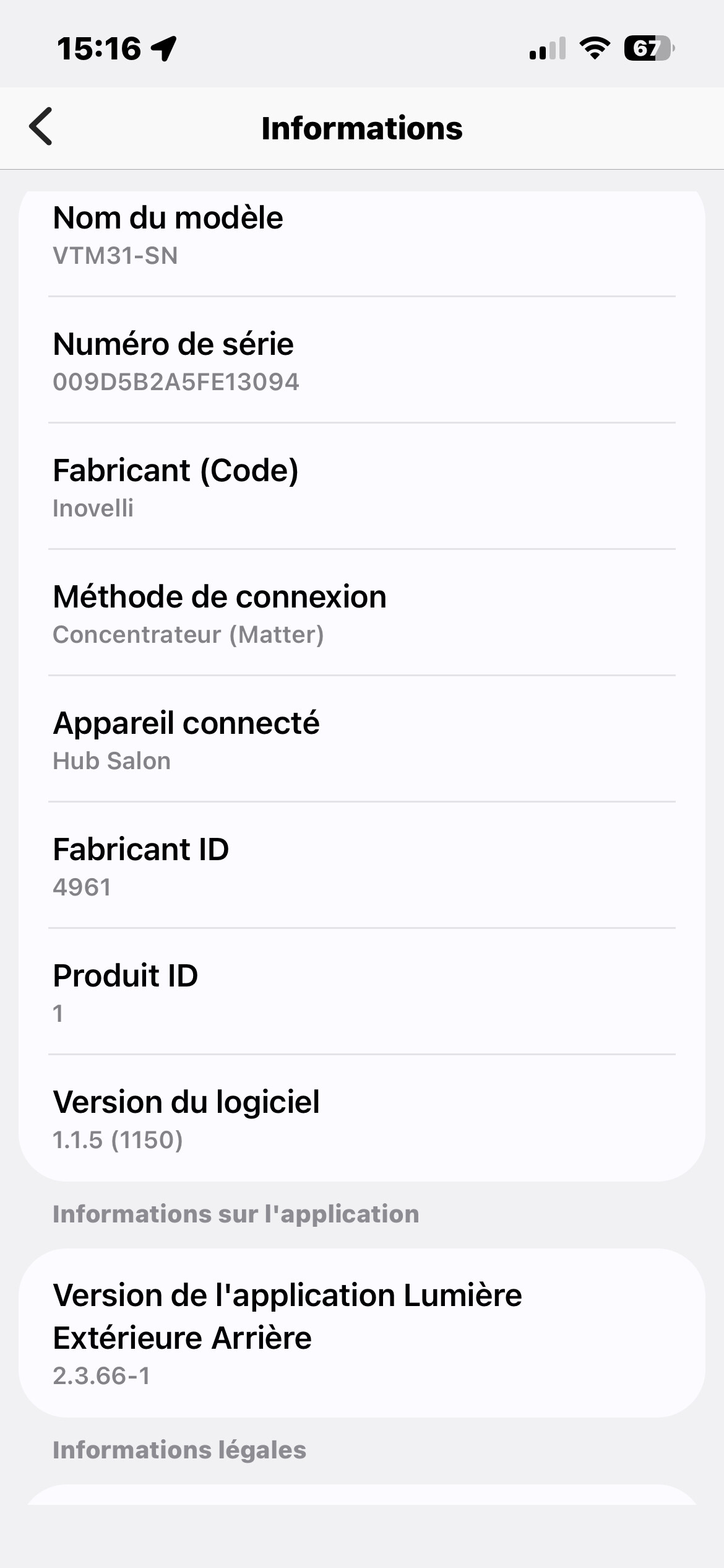

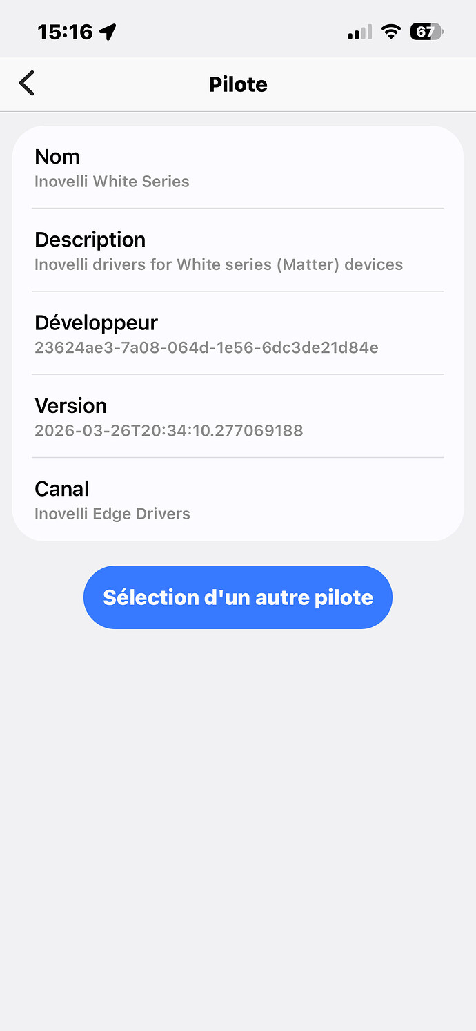

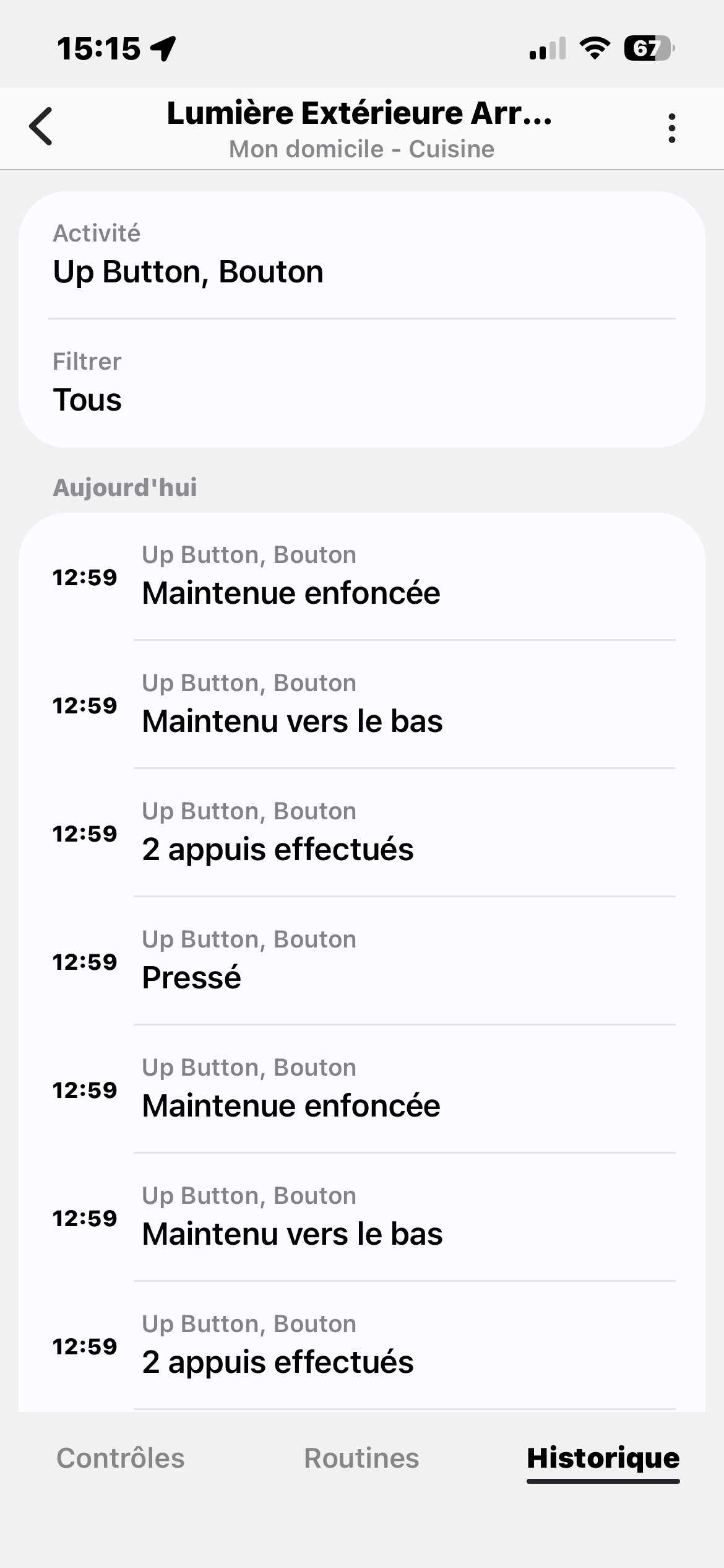

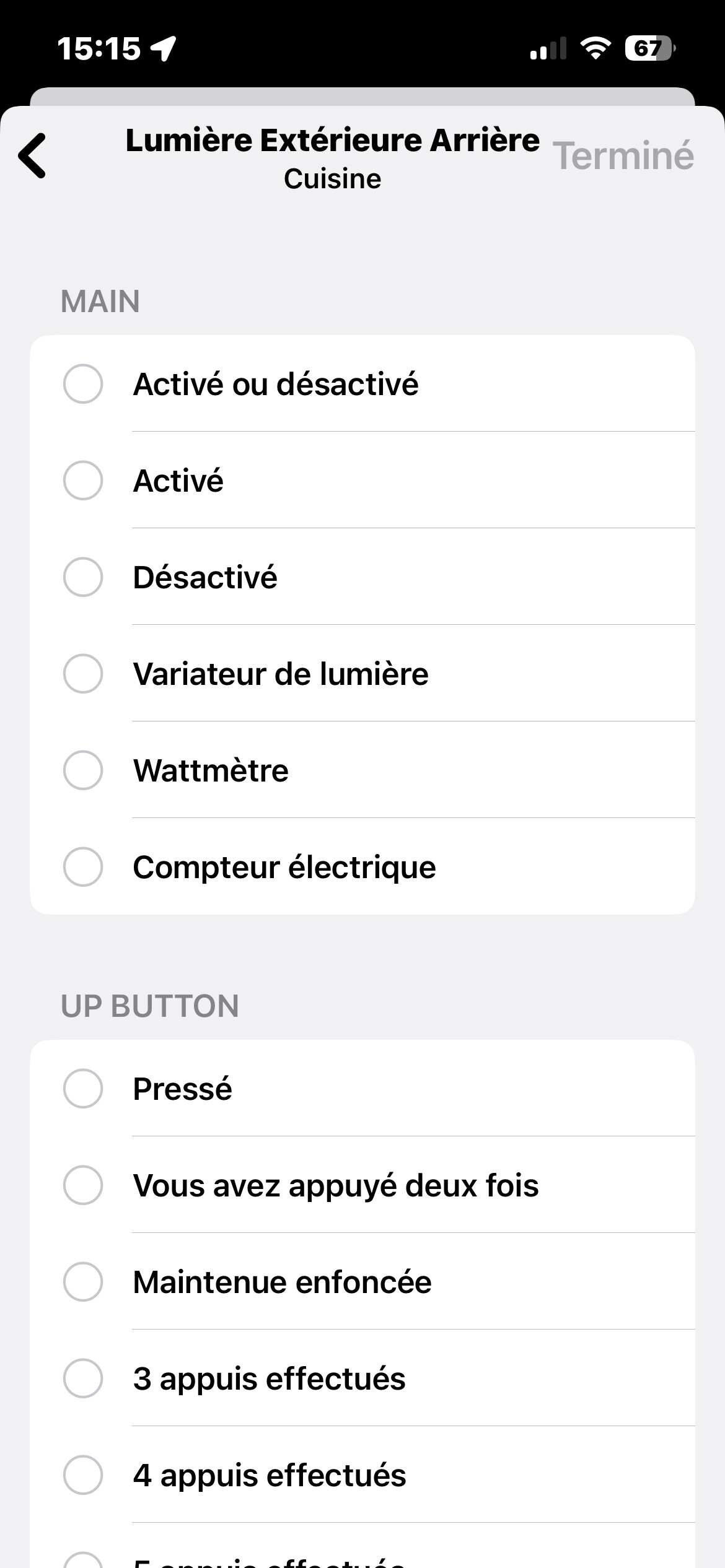

I just noticed that my SmartThings routines triggered by the double-tap (2x) button press have stopped working since updating my VTM31-SN to firmware version 1.1.5.
All other triggers (3x, 4x, 5x, and press-and-hold) are still working correctly, but the 2x trigger is not.
I found that there was an error in the routines, and I had to reselect the trigger because its name changed to “Pressed Twice”. However, even after fixing that, the routine still does not trigger.
In the device history, I can see that the event label appears differently (e.g., “2 presses detected”), which makes me think there might be a small glitch with the SmartThings Edge driver.
I’ve attached some screenshots to help illustrate the issue.
Thanks for your help!
