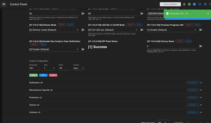

Using that Custom Configuration feature, I’m able to get values for P101 - P107, but I haven’t been able to successfully set a value. It always throws an error.
Here’s a successful get:

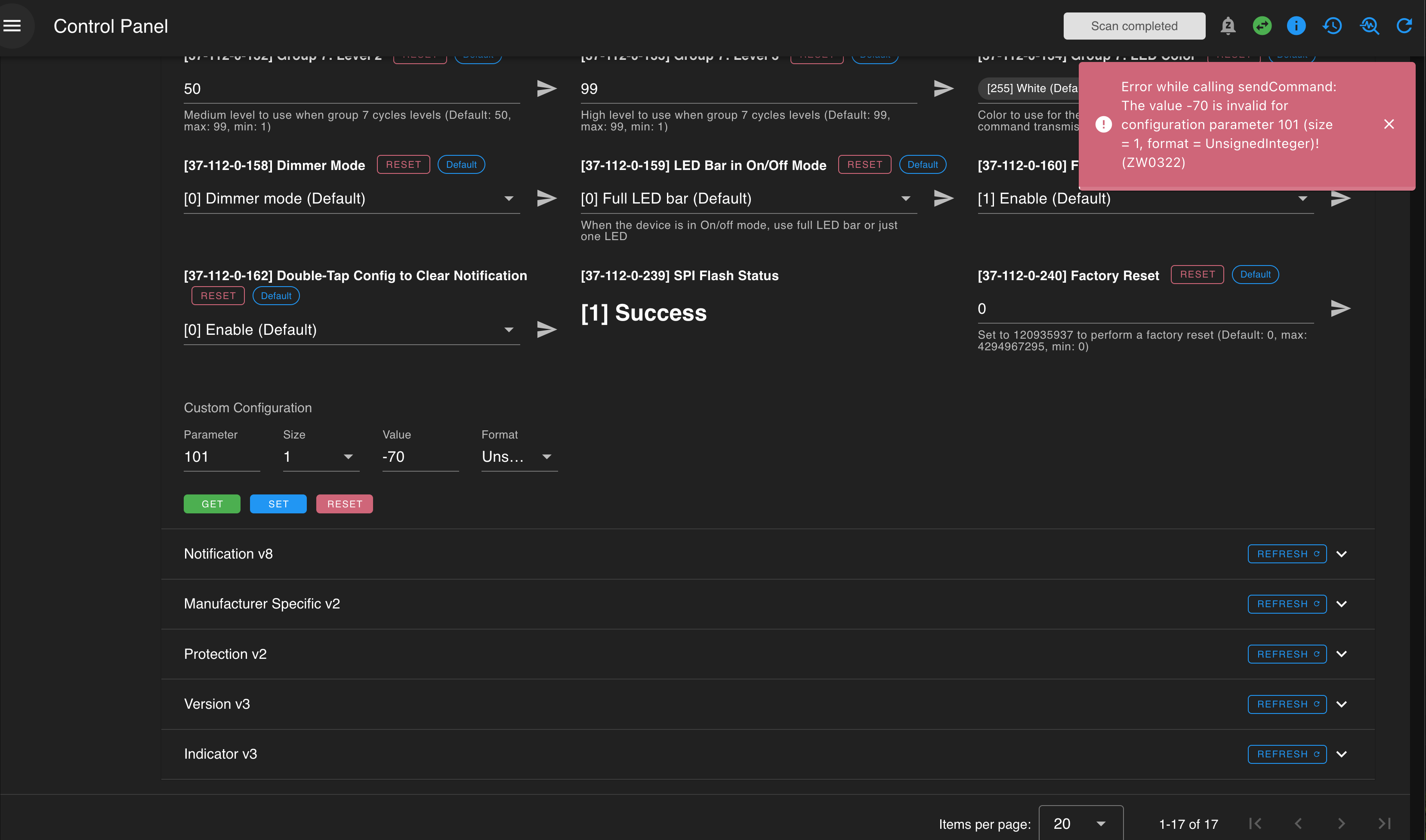

Here’s a failed set. This is just trying to change P101 from -75 to -70. I tried both signed and unsigned, and sizes 1 through 4; all throw errors.

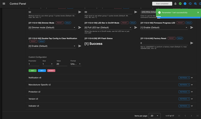

Yet any other parameter, like P1, I can set successfully.
This is the relevant log item:
2026-01-21 18:21:12.731 INFO Z-WAVE: The value -70 is invalid for configuration parameter 101 (size = 1, format = UnsignedInteger)! (ZW0322) sendCommand undefined
I think this is revealing. There’s some underlying issue with setting these P101 - P106 parameters.

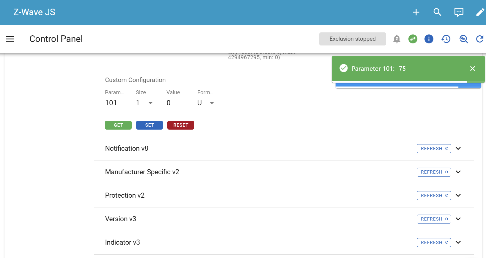

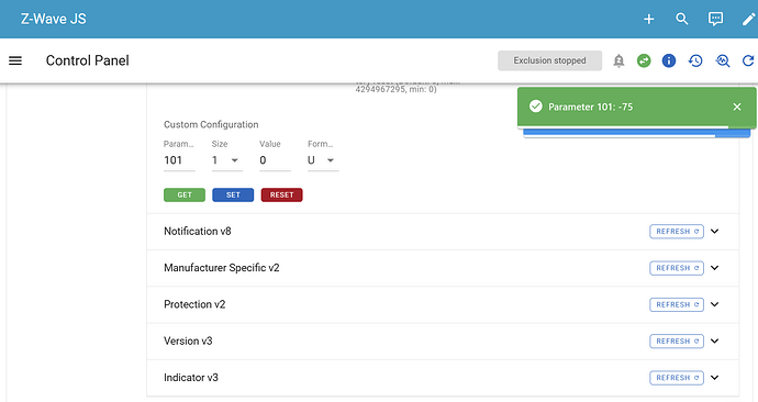

@peterscene They should be settable by changing the size to 2 and the Format to signed. I tested setting 101-106 with those settings and did not get the error. I am curious if you change the setting in the way that you have been (in Home Assistant) and then go back to the Zwave js UI and do a “Get” if it shows the values you entered in the HA UI.
Ah, yes, you’re correct: Size 2 Signed does work for setting P101.
I changed P101 to -50 in the Home Assistant device page, under the “Configure” button, as I have been doing. Switching back to Z-Wave JS UI, running the get command, it does indeed reflect the change: it returns -50.

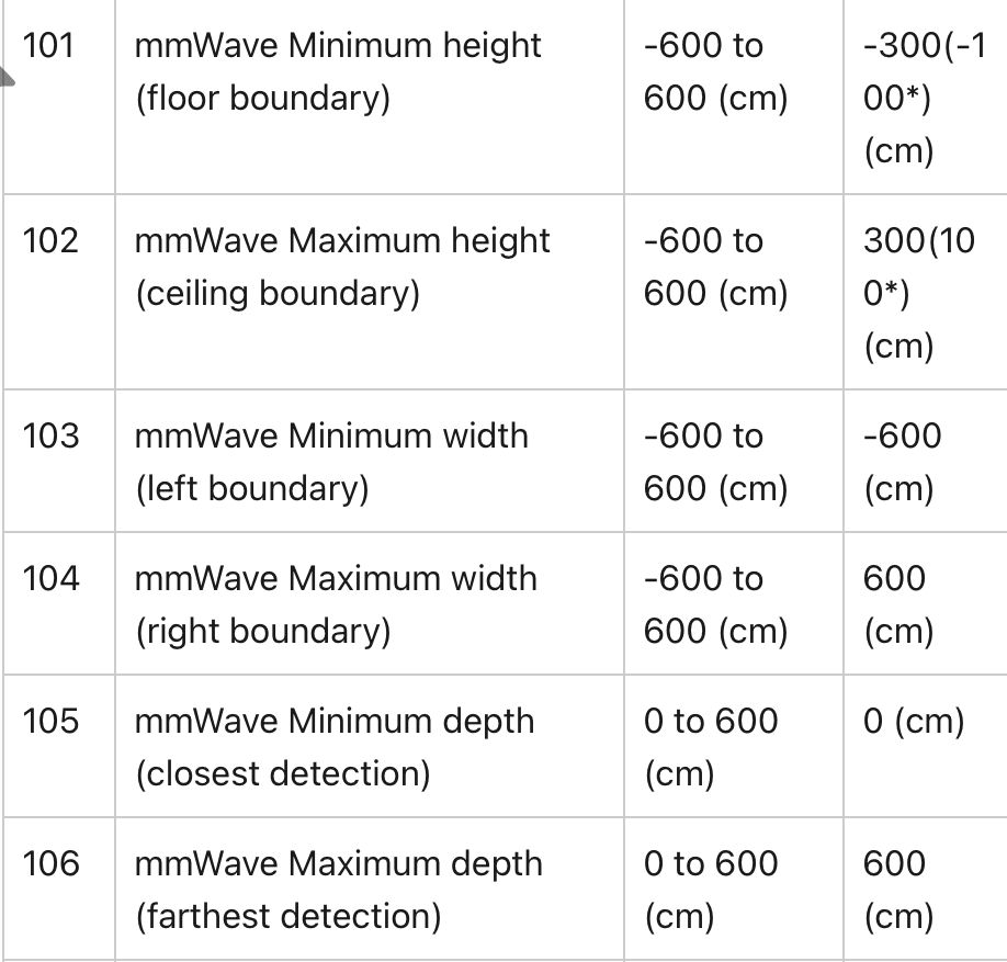

I don’t have a visual for you, but I can talk you through this.
These are the distances from the switch to each of those planes. You’re basically telling the switch what “box” to detect motion in” relative to where the switch is installed.
I found the easiest way, if you have the tool, is to use a laser measuring tool. Set it to metric mode, stand near your switch, and take measurements for each of these parameters as follows as if you are standing with the switch directly behind you…
101: Point it at the floor and record that measurement. Since it’s “under” the switch, make the value negative. If you have furry friends you want to NOT trigger presence, you might want to subtract 50-100cm or so.
102: Point it at the ceiling and measure. Use the positive value since this is “above” the switch. You may want to consider reducing this value slightly by 50-100cm or so if you have a ceiling fan since those will cause the mmwave sensor to detect motion.
103: Similar to the floor measurement, but this time point it to the left; again, since it is “left” of the switch, negate the measurement.
104: Measure to the right this time; positive measurement.
105: Usually you’ll want to keep this at 0, but if you wanted to push that imaginary “box” where presence detection starts further away from the switch, you can put a positive value here. Negative values won’t work (it can’t “see” backwards”)
106: Measure to the wall opposite the switch.
With any of these you can of course adjust for any weird geometry, but that’s the basic idea.
Again, if you have a laser measuring tool, it’s super quick and you don’t have to move much if at all to grab the 6 measurements.
