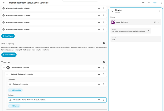

  • Finally, is there a recommendation on how often is reasonable to change the DefaultLevelLocal parameter? I set it to 100% during the day, and 20% at night, but my rule also ramps it down slowly over time in the evening. So is twice a day fine, but say 50 times a day in danger of prematurely wearing out internal flash?

I would say that there is little concern about wearing out the flash. I have put my blue switches through quite a bit and haven’t had any failures yet (about 4 years of use?). I will double check with the engineer though. I personally have setup a schedule in HA to set the Default Level Local and am able to limit to about 4 times for most switches. I am not the best at doing automations in HA so there is probably a better way to do this.
