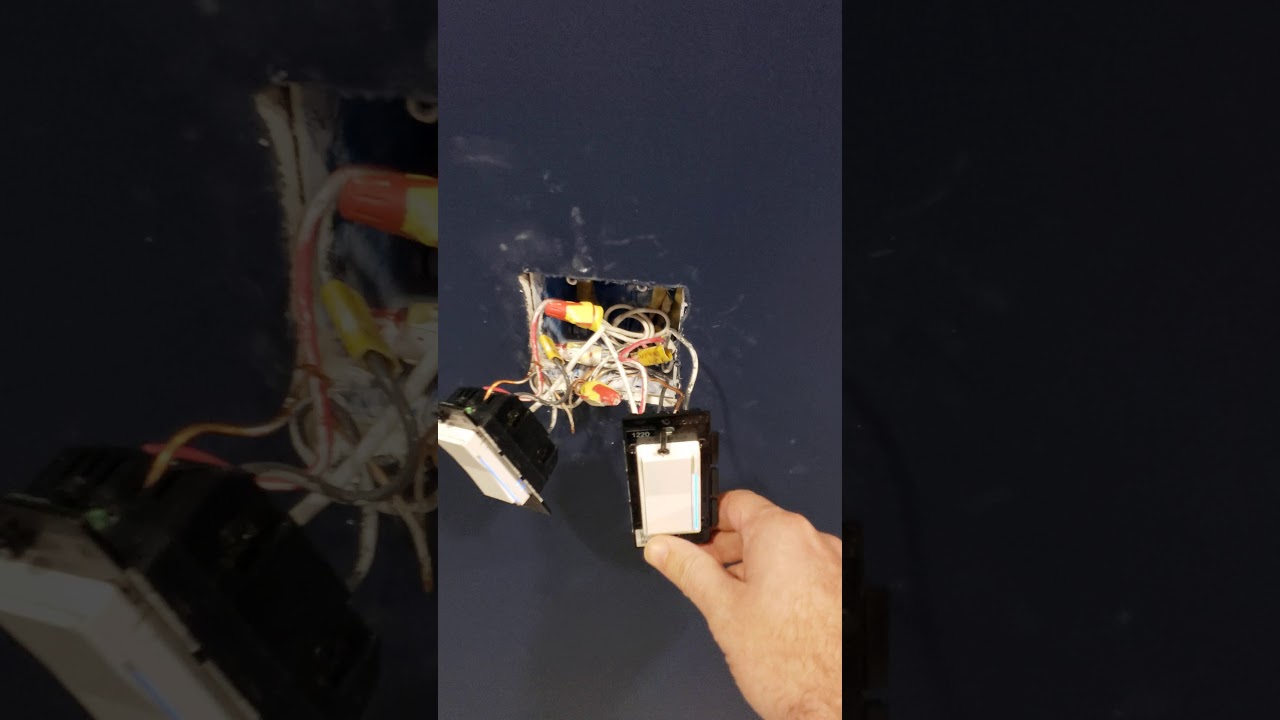

Do you want me to make a longer video showing it playing out? Didn’t know if that would help anything?
It wouldn’t hurt! At the very least we can show the manufacturer.
Here is the longer video. As you should be able to see, if i totally ignored the dimmer, all the other switches would work fine. Something in the dimmer is weird. Please help.

Yeah, that’s kinda what it has seemed to me from the beginning that its a setting or something in the programming of the switch. Like you said, I’ve tried 2 dimmers same result. I’ve swapped the dimmer with a dumb switch and all works as should, and as stated, you don’t need to change wiring with any dumb switches. So that settles wiring. I tried the incandescent bulb (even bought a 100 watt one so would use more power) and no change. That and the fact that these same lights work on a single pull setup and a different 3 way with less lights, and they work perfectly. The only thing that’s different is there is 3, 4 way switches in the middle, and it’s acts wonky. I’m not interested in putting aux switches in because at that point I’ll be about $120 into this one deal and it’s just not worth it. I did try a couple “wrong” settings when we started, I think it was for the 3 way step, but I’ll try more. Is there any certain ones besides that one and the neutral sep that I should try? At the end of the day, I guess I can just put a dumb switch in there or try a different brand and see if they work. I don’t know what else to do.
This isn’t really my problem. All of my dumb switches will turn on/off the lights. Doesn’t matter which of the 4 dumb switches I go to and in what order. Turn on at switch b, off at c, on ad d, back off at b. All of those work fine. It’s the dimmer that is acting goofy.
