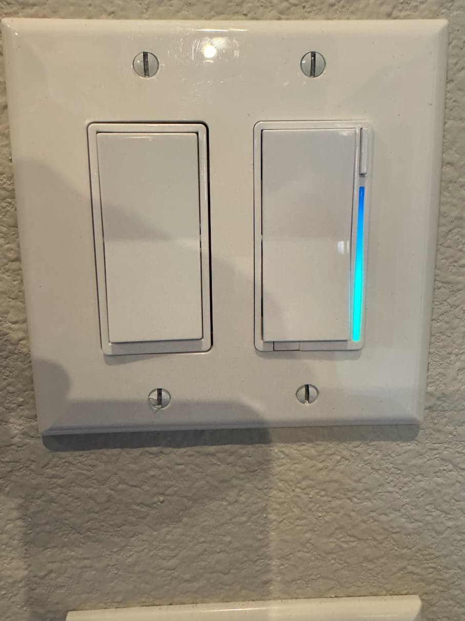

Here’s a pic of my HomeSeer dimmer with LED 1 set to green and LED 2 set to cyan.
And a pic of my Inovelli Blue Smart Dimmer with the same settings.
With the Inovelli dimmer, I can’t tell what the individual colors are; it just blends to an overall ugly appearance. With the HomeSeer dimmer, I can clearly tell LED 1 is green and LED 2 is cyan.
