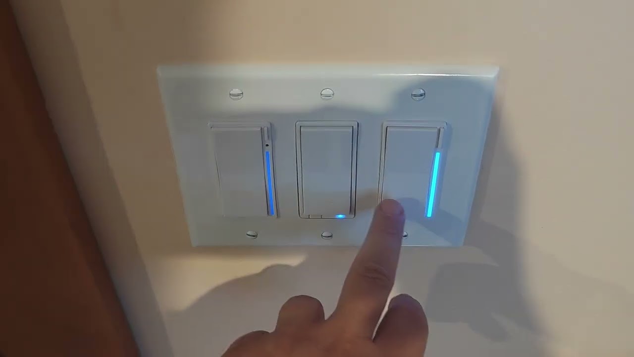

Like the last few firmware upgrades, it takes several tries before an update takes–I watched a switch show the blinking green progress bar, then flash red three times, then go through an update again with the progress bar, etc… It did eventually get upgraded though. But it’s been almost 40 hours, and 6 out of 15 switches have been upgraded to 2.15. Eight are on 2.14, and one is on 2.08.
And I watched another switch attempt to go through its upgrade, and it didn’t do the three red flashes. The LEDs flashed green for several minutes, then went off, then the connected load turned off, then the LEDs cycled green, blue, yellow (I think), then the load turned back on. However, it did not get upgraded (still on 2.14), and it’s now showing the flashing green progress bar again. Also, about two or three minutes after that, the connected lights flashed on and off rapidly (which I’ve seen during both successful and failed upgrades).

Anyways, I was wondering exactly what the above LED patterns mean. I’m assuming red flashes means error, but what sort of error? (Switch got corrupt/incomplete firmware? Or firmware was OK, but it had problem flashing it? Or it could be either?) And what about green/blue/yellow? I was thinking that might mean success, although I haven’t watched a success flash to see what it looks like. But as mentioned, in this case, it wasn’t actually successful.

And yes, @jtbandes, mine flicker during the update. Scared me to death the first time it happened, as I thought the switch was shorting out until I saw the green led.

As before, the switch shows the blinking green progress bar. And with the new HA/ZHA, the web UI also shows a progress bar. After it reaches 100%, the switch LEDs stay off for a few seconds, then cycle cyan, blue, yellow. The switch remains on version 2.14. I’ve tried doing a factory reset (hold up and config buttons until the LEDs turn red) and re-adding the switch to HA, but that didn’t help.

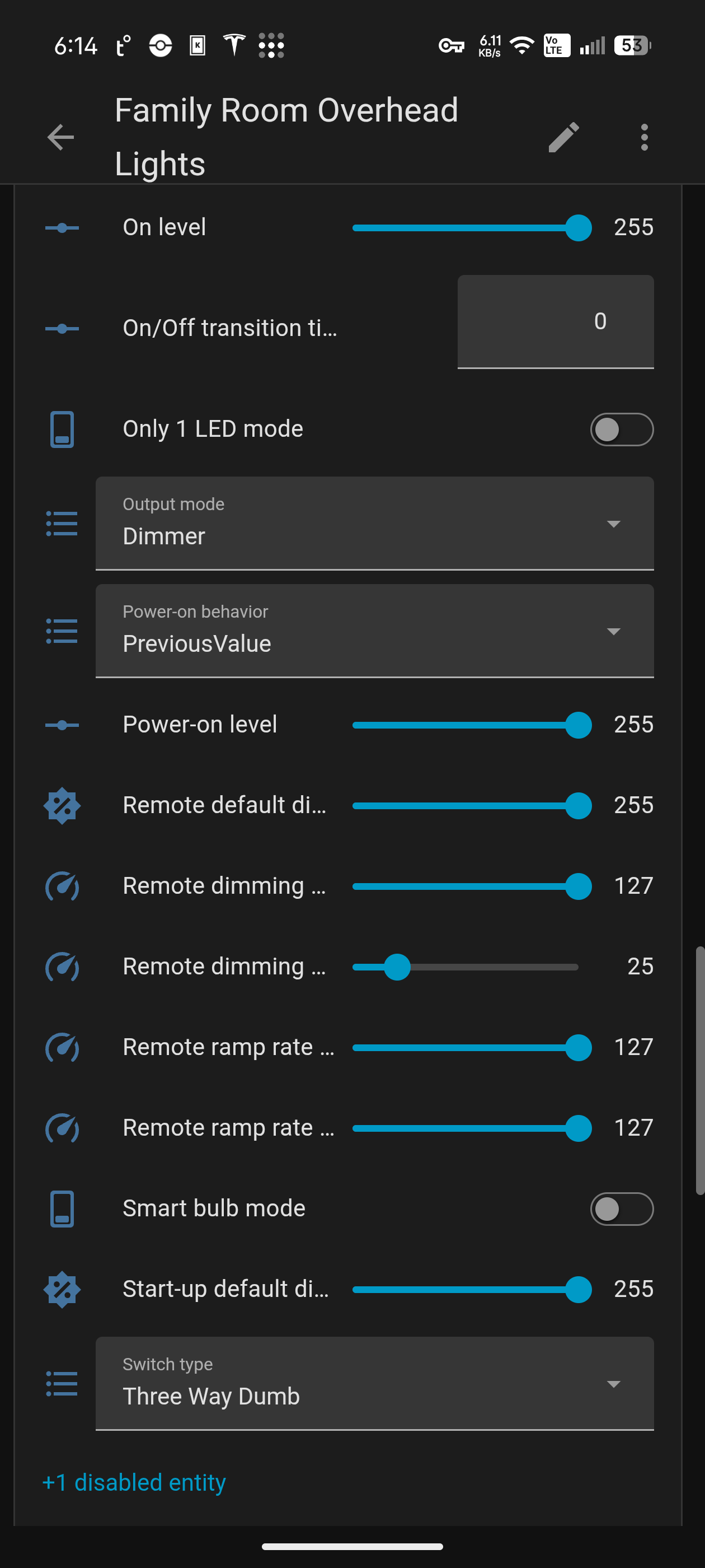

Encountered an issue after doing the update where the switch doesn’t work properly in a 3-way setup. Performed factory reset, confirmed it’s on the latest firmware.
